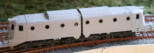

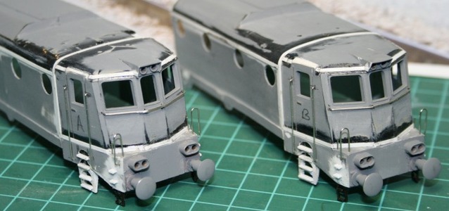

il mio modello come base ha avuto come gia scritto sia per il modello sz 342 e quello croato 1061 la 646 della roco ho trovato il scritto dell'amico anderslej su come ha costruito il suo modello della sz 362 su base di un modello 646 ma rivarossi unica cosa il testo e' in inglese-
The Rocoi model before disassembly all the bits after disassembly! The body is 2mm too wide so this dimension was removed from the center, and 1mm from this to each side of the outer cab windows.One body section with the cuts made but not completely parted, below: the seperate parts.right and below right: the parts glued together, and reinforced on the inside.The slimmed down version shown in comparison with the unmodified half, which still needs the surgery
The second body half was cut and reglued as the first. Whilst this was setting I made the new bodysides, as the 362 is completely different then the E.646. There are four porthole windows on each side panel, after marking out I drilled a 1.6mm pilot hole in each, then made a tool to cut these out and esure they are all the same size. The tool is a sort of single tooth hole saw, it is made from a strip of hard nickel silver, filed to a sharp point. The point was then bent at right angles and a 1.6mm hole drilled at the correct radius of the holes. An 8 BA nut was used as a spacer and the 1.6mm drill bit was inserted in the pilot holes then the cutter scribed round which deeply scored the hole diameter. Spoke like cuts were made with the scalpel and the centers simply pushed through with a pencil. The time to make the tool and to cut out all the holes was about 5 minutes!Both body sections have now been reassembled with the new side panels. The cabs are only tacked in place for alignment purposes. Final assembly will be after more work on the cab sections.
A lot of smoothing to be done, then a coat of primer to show up any imperfections. New buffer beams and side valances will be added The new bufferbeams and side valances. The different shape of one pair are because only one side of each cab has a door, and the deeper part incorporates the cab steps.right: The items fitted to cab fronts. Also shown are the light units, made from two pieces of 1.6mm ID brass tube with a wrapper of thin brass. These will be inserted into the buffer beams. Fibre optic cable will be used for the headlightsThe basic body sections have been assembled and sprayed grey primer to show up any imperfections. Only a small amount of further smoothing is neccessary, before detailing continuesVarious beading has now been added plus door handles and a grab on theroof near cab A.Next will be the cab steps and the steps near buffer beams Various handrails and grabs have now been fitted, also cab and front steps.
Above is the locomotive which will donate the chassis for the 362. This is a roco fs 646 and it is a superb runner, it also
has more correct bogies for the 362. Above right is the excellent mechanism.Below left are the 362 body halves in front of the fs 646 But as the wheelbase of the fs 646 is too short, and this is a beautiful locomotive, it will be kept as it is - these locos do run into Ljubljana - this is all the excuse I need to keep it! right is a close up showing the turned brass porthole frames, simply made by parting off sections of brass tube in my lathe.Some resin castings are underway.Left shows the pattern for the bogie sideframe (top) and the first castingoff the mould (bottom).Right is the brass pattern for side grilles castings will be needed off this. This is currently in a mould along with the sand box and small grilles near a porthole The body halves have been pressed onto the chassis to test clearances. The cab steps will have to be adjusted as the bogie
frame just touches them on my tightest curves causing the bogie to derail. The sandboxes have been fitted and the frames painted.Next job is to fit the body sections at the correct height and position, then body detailing can continue.
The body sections are now fitted and the bellows section is the original one narrowed slightly. A DCC decoder has been installed.Roof vents, side grilles, cab air-con units and pantographs are fitted.Many more fittings to add, such as roof insulators and bars, buffer beam details, snowploughs, cab interiors, lighting, various cabling/pipework, etc.
spero che chi sa' l'inglese non abbia problemi ...un aiuto con il traduttore anche s'e' non e' il massimo..

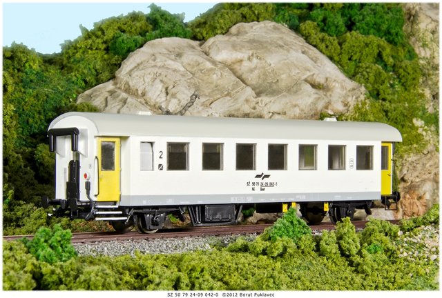

oggi vi presento il vagone di produzione commerciale in kit della ditta slovena ''klub baat''serie
SŽ Baat 2 ° classe -bagagliaio -50 79 24-09 042-0-viene usato sulla linea transalpina sul servizio chiamato ''avtovlak''-
il video della composizione in ho con in testa la locomotiva serie sz 643 prodotta dalla ditta moko-slovenja- :mrgreen:
http://youtu.be/UfFNtEh4Lio
un grazie a lucio chermaz-gli amici di campo san martino-paolo castiglioni :D
il video reale :mrgreen:
http://www.youtube.com/watch?v=oQ01zCf4 ... WKJuEcAs3w
il mio sito
Luca's train page
http://trainpagesofluca.net/
per informazioni sul vagone sz baat mettersi in contatto
baat@vlaki.com
meh 362
Commento file: il vagone sz baat

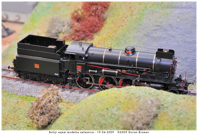

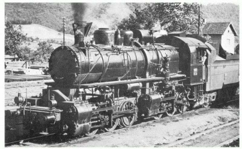

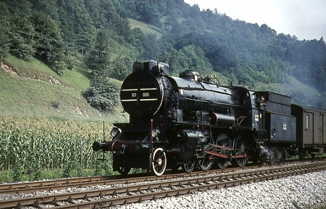

ciao tutti oggi parliamo di un signor modello e di una bella vera locomotiva a vapore che anni fa' veniva usata per fare
treni storici ancora sotto la yugoslavija e in slovenija,ora si trova per chi volesse vederla al museo siska di ljubljana.
parliamo della jz-sz serie 03- questa serie di locomotive furono costruite al fine di ridurre i tempi di viaggio tra Vienna e Trieste in 10,5 sulla linea Südbahn il progetto iniziale della locomotiva e'stato elaborato congiuntamente dalla Steg e stabilimenti in Floridsdorf e Wiener Neustadt e nel 1914. eri ha consegnato 44 locomotive di questa serie distribuite a Vienna, Trieste, Innsbruck e Maribor.
Dal 1913 MAV Gépgyár a Budapest inizia la produzione di questa locomotiva è numerata come MAV 302-
Dopo la prima guerra mondiale 13 locomotive della serie è andato alle JDZ non sono nate nel1932 le locomotive serie jz 06, le JDZ / SW 03 1932 hanno trainatato prestigiosi treni ci internazionali come il Simplon-Orient e l' Orient-Express tenuto conto del fatto che esse facevano parte del dipartimento ferroviario di Lubiana hanno lo stesso lavorato anche in croazia fino al 1968 con treni merci e passeggeri da Lubiana a Zagabria a Pola per poi venire radiate dal servizio.
dati tecnici
Lunghezza ai respingenti 17 54 m
Volume di un cubo di acqua 16. M.
V max 90 kmh
notizia dell' ultima ora pare se tutto va' bene lo produrra' nel 2013 anche roco
ecco il filmato con un grazie all'amico tine con il modello produzione limitatissima 10 pezzi Micro Metakit -sz 03 in partenza la povera 03 ha il singhiozzo ......
il video
http://www.miniaturna-zeleznica.com/avd ... lsjak.html
Luca's train page
bye meh 362
Commento file: un grazie a modelni vlaki
20090419_0179.jpg [ 137.09 KiB | Osservato 17465 volte ]
Commento file: al vero.......
jz-03.jpg [ 114.39 KiB | Osservato 17476 volte ]

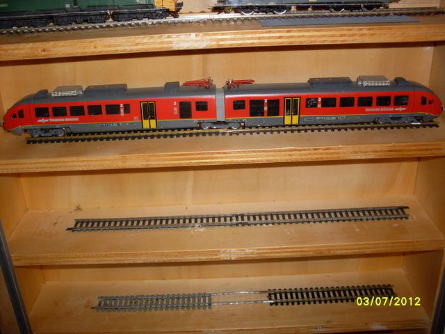

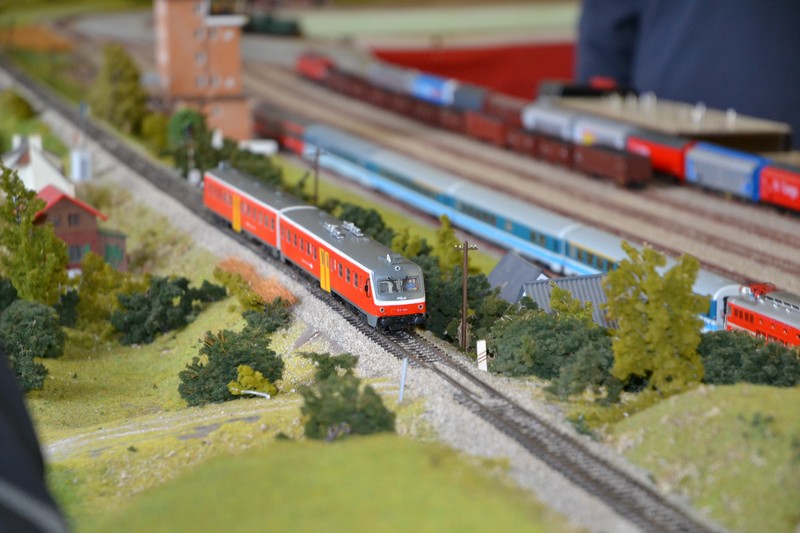

Ciao .... oggi vi presento la classe SZ 711 è una unità diesel multipla, prodotto da MBB Donauwörth nel 1970 e che attualmente operano nelle ferrovie slovene. Il progetto tecnico si basa su la tedesca Deutsche Bahn classe 624.
la storia ........
Questo treno ha operato sulla tratta Lubiana - Beograd come "EMONA-EXPRESS" E 'stato uno dei treni più confortevoli nella ex Jugoslavia, aveva l'aria condizionata, sedili molto comodi le hostess e gli annunci venivano fatti dagli altoparlanti. Questo treno è il ben noto "Zeleni vlak" delle Ferrovie slovene, che è ancora oggi in servizio, ma non più come un treno di lusso anche sulla linea istriana......
il modello ho autocostuito con i dettagli di ottone e plastica legno -
qui un video dell' amico lucio chermaz sulla linea di capodistria-slovenja- con ripresa anche
l'automotrice sz 711 in livrea originale :mrgreen:
VIDEO- :)
http://youtu.be/lQJzR2FcpFo
il mio sito
:D
bye meh 362
Commento file: sz 711
sdc12724i.jpg [ 104.58 KiB | Osservato 17332 volte ]

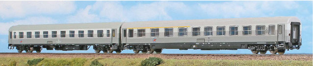

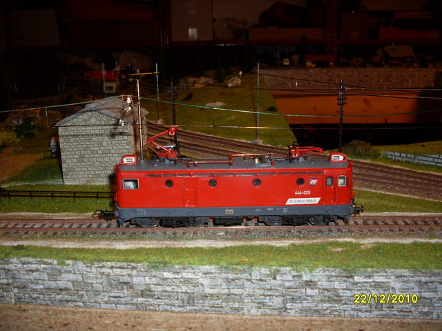

composizione intercity C 342/343 Ivo Andrić Beograd 2012
ciao oggi vi presento la composizione del treno intercity C 342/343 Ivo Andrić Beograd 2012 - Novi Sad - Subotica - budapest -
composizione ho
Zs Beelmt - non è in produzione, forse acme in futuro........
H-START Bmz - Roco 44497/ACME 52012
H-START ABmz - Roco 44498

Commento file: locomotiva elletrica ferrovie serbe
zs 444 modello autocostruito
sdc14250l.jpg [ 137.34 KiB | Osservato 17284 volte ]

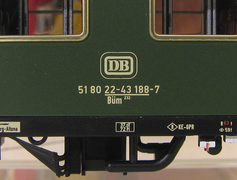

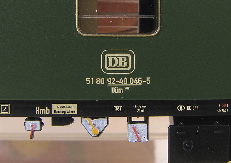

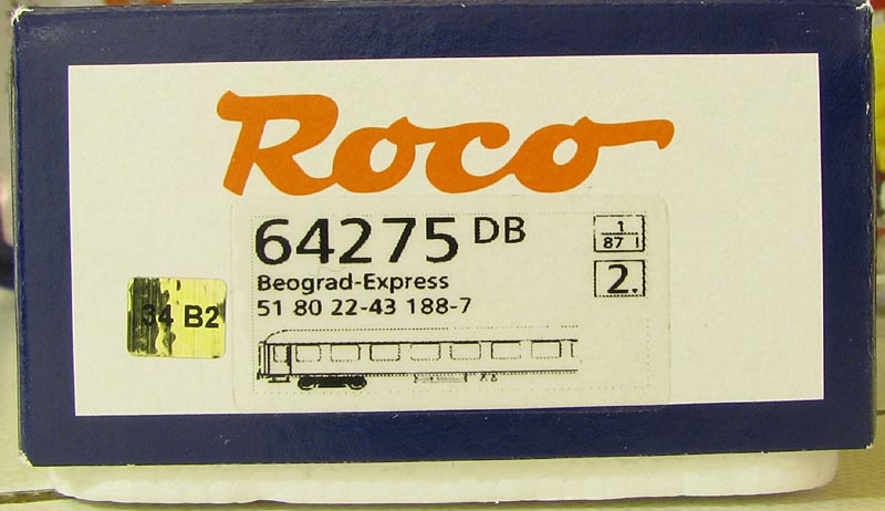

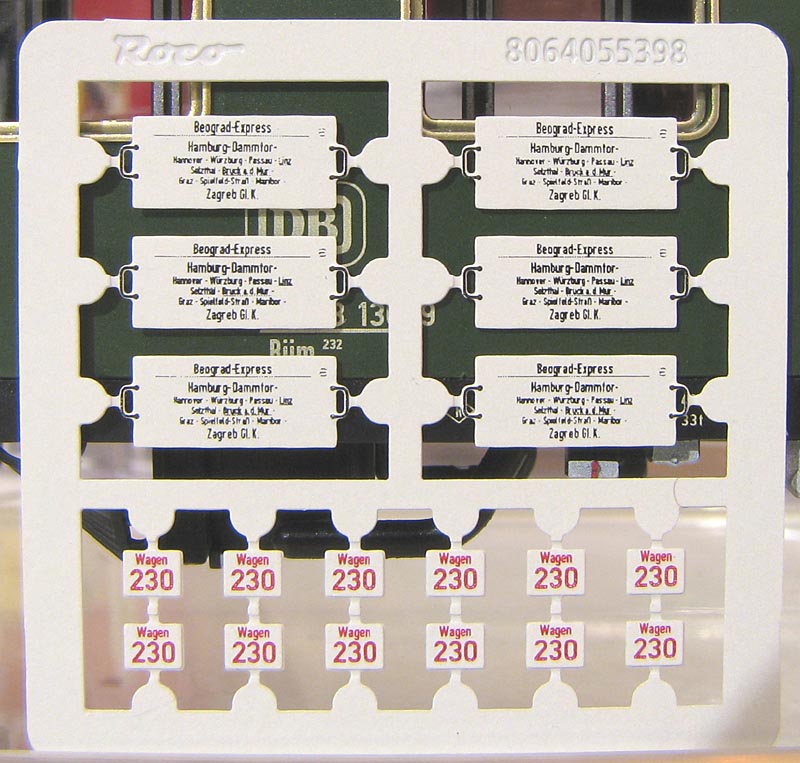

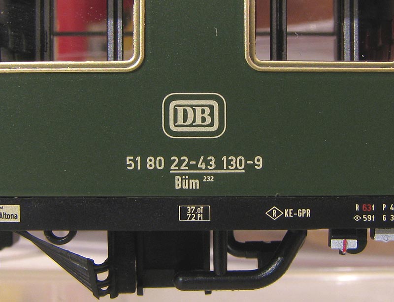

saluti per chi amano le composizioni eccone una interessante...... dall'orario 1971-72 quella del treno beograd express -
--- DB Dms Hamburg-D. - Beograd
222 DSG WLAB Hamburg-D. - Beograd
223 DB Bcm Hamburg-D. - Beograd
225 DB ABm Hamburg-D. - Beograd
226 DB Bm Hamburg-D. - Beograd
227 DB Bm Hamburg-D. - Beograd
228 DB Bm Hamburg-D. - Beograd
229 DB Bm Hamburg-D. - Beograd
230 DB Bm Hamburg-D. - Zagreb
231 DB ABm Hamburg-D. - Zagreb
232 DB Bm Hamburg-D. - Maribor
233 DB ABm Hamburg-D. - GrazDie
la composizione in ho un grazie all' amico dragan-
http://www.youtube.com/watch?v=LQ_WY0YL2CI
il mio sito :mrgreen:
saluti meh 362
ROCO_64275_a.jpg [ 73.86 KiB | Osservato 17220 volte ]
ROCO_64275_b.jpg [ 82.2 KiB | Osservato 17220 volte ]
ROCO_64056-2_b.jpg [ 73.86 KiB | Osservato 17220 volte ]
ROCO_64055-3_b.jpg [ 92.96 KiB | Osservato 17220 volte ]
ROCO_64055-2_b.jpg [ 82.88 KiB | Osservato 17220 volte ]
ROCO_64055-1_b.jpg [ 86.81 KiB | Osservato 17220 volte ]
ROCO_64055-1_c.jpg [ 137.57 KiB | Osservato 17220 volte ]

saluti e auguri a tutti di buona Pasqua oggi vi presento due video uno realizzato sul mio ''plasticheto''e dedicato alle l'altro fatto dall' amico lucio sulla linea che porta verso koper-capodistria-
video :mrgreen:
http://www.youtube.com/watch?v=P54nqosG ... f0ZpLjSD1g
video :mrgreen:
http://youtu.be/LJ08tId7Sb8
il mio sito :D
Commento file: la mia automotrice autocostruita sz 813.100 sulla linea transalpina
dsc0192.jpg [ 159.19 KiB | Osservato 17146 volte ]

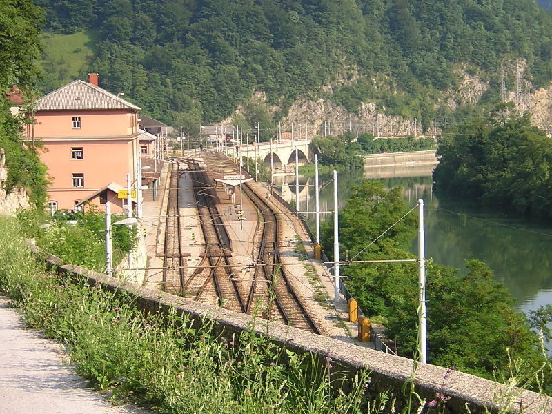

saluti un nuovo video questa volta su una stazione molto importante la stazione slovena di zidani most dove partono due direzioni internazionali importanti verso maribor e l'austria e verso la stazione di confine dobova verso la croazia dell' amico lucio
IL VIDEO :mrgreen:
http://youtu.be/_zeNyyqwN7Y

saluti e buon carnevale a tutti oggi vi presento due video uno realizzato sul
mio ''plasticheto''e dedicato alle locomotive vapore l'altro fatto dall' amico
brigita 363 lungo la famosa linea ''transalpina'' con la vaporiera slovena sz 33 037-
gli edifici e i ponti sul ''plasticheto''sono stati realizzati dall' amico
bostjan jarc-
:mrgreen:
video
http://www.youtube.com/watch?v=hok7L6g2 ... f0ZpLjSD1g
un grazie per il video all' amico brigita 363
saluti meh 362
lok33a.gif [ 4.67 KiB | Osservato 17146 volte ]

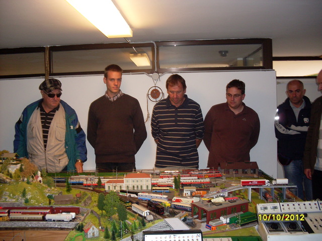

saluti riguardo al mio plastico in un altro topic e' gia stato preso in considerazione e dati tanti giudizi....questo video l'ha fatto l'amico dean e josko assieme al club sloveno Društvo ljubiteljev železnic Ilirska Bistrica per capirsi il club che l'anno scorso hanno restaurato una locomotiva jz 361 sono venuti a farmi visita e mi era sembrato come ringraziamento di dedicare un topic alla loro gradita visita......
IL VIDEO :mrgreen:
http://youtu.be/jr1nJZCs8y0
a chi interssa questo club e cosa si occupano il loro link :arrow:
http://dlz.ilbis.com/
LA MIA HOMEPAGE :D
bye meh 362
