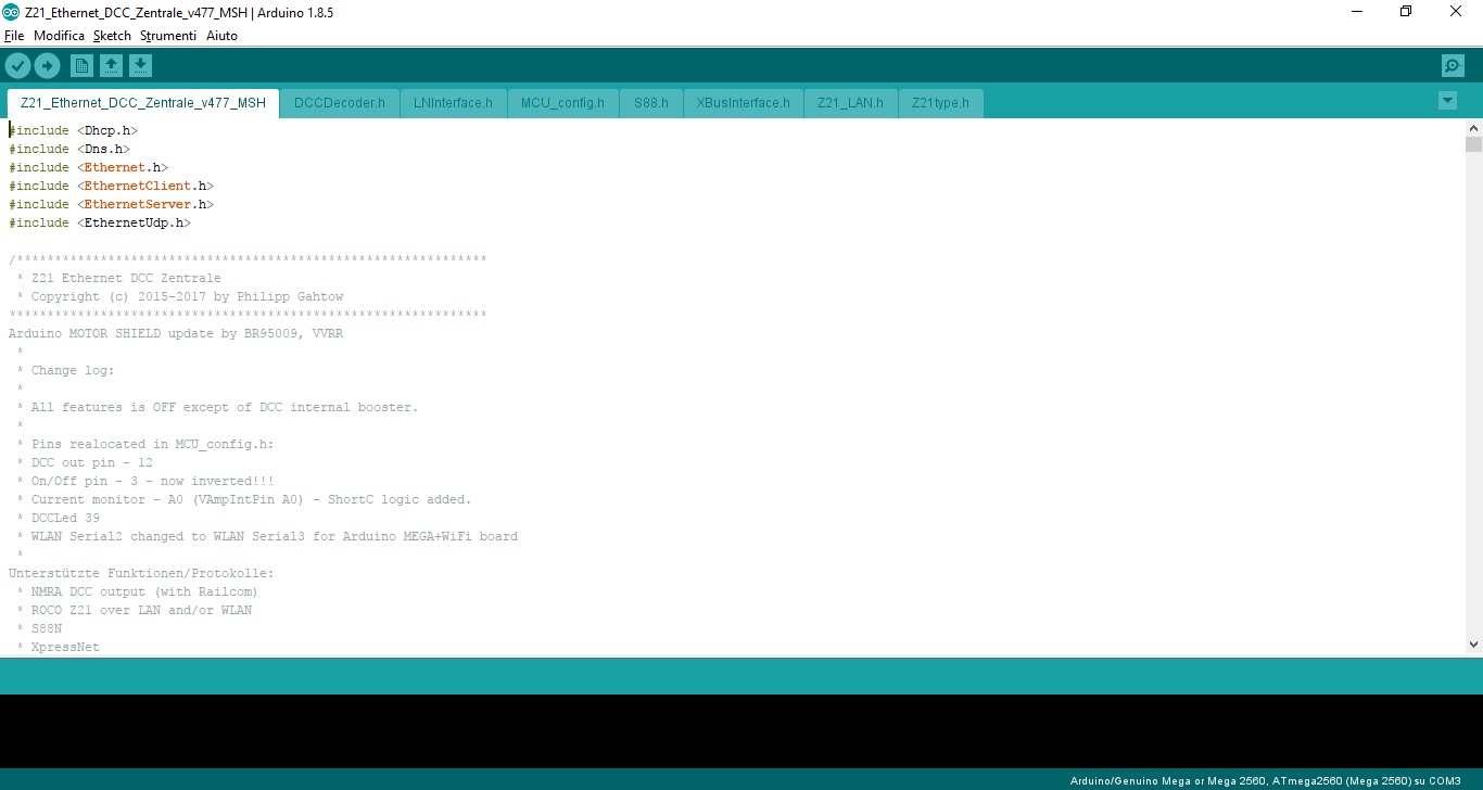

MessaggioInviato: lunedì 19 febbraio 2018, 20:00
Iscritto il: sabato 11 dicembre 2010, 22:18
Messaggi: 800
Località: San Giovanni La Punta (CT)
Mi è arrivato l'Arduino Mega e la ethernet shield, ho seguito le istruzioni saltando la parte che riguarda il wifi, ma nella compilazione mi da tantissimi errori:
Arduino:1.8.5 (Windows 10), Scheda:"Arduino/Genuino Mega or Mega 2560, ATmega2560 (Mega 2560)"
In file included from C:\Users\Michele\Desktop\z21\Z21_Ethernet_DCC_Zentrale_v477_MSH\Z21_Ethernet_DCC_Zentrale_v477_MSH.ino:314:0:
sketch\Z21_LAN.h: In function 'void Z21LANreceive()':
Z21_LAN.h:264: error: 'notifyz21getSystemInfo' was not declared in this scope
notifyz21getSystemInfo(0); //SysInfo an alle BC Clients senden!
sketch\Z21_LAN.h: In function 'void notifyz21getSystemInfo(uint8_t)':
Z21_LAN.h:417: error: 'class z21Class' has no member named 'sendSystemInfo'
z21.sendSystemInfo(client, inAm, volt, temp); //report System State to z21 clients
sketch\Z21_LAN.h: In function 'void notifyz21CVREAD(uint8_t, uint8_t)':
Z21_LAN.h:430: error: 'class DCCPacketScheduler' has no member named 'opsReadDirectCV'
dcc.opsReadDirectCV(cvAdr); //read cv
sketch\Z21_LAN.h: In function 'void notifyz21CVWRITE(uint8_t, uint8_t, uint8_t)':
Z21_LAN.h:435: error: ambiguating new declaration of 'void notifyz21CVWRITE(uint8_t, uint8_t, uint8_t)'
void notifyz21CVWRITE(uint8_t cvAdrMSB, uint8_t cvAdrLSB, uint8_t value)
In file included from C:\Users\Michele\Desktop\z21\Z21_Ethernet_DCC_Zentrale_v477_MSH\Z21_Ethernet_DCC_Zentrale_v477_MSH.ino:221:0:
C:\Users\Michele\Documents\Arduino\libraries\z21/z21.h:118:17: note: old declaration 'uint8_t notifyz21CVWRITE(uint8_t, uint8_t, uint8_t)'
extern uint8_t notifyz21CVWRITE(uint8_t cvAdrMSB, uint8_t cvAdrLSB, uint8_t value) __attribute__((weak));
sketch\Z21_LAN.h: In function 'void notifyz21CVPOMREADBYTE(uint16_t, uint16_t)':
Z21_LAN.h:471: error: 'class DCCPacketScheduler' has no member named 'opsPOMreadCV'
dcc.opsPOMreadCV(Adr, cvAdr); //get decoder value
sketch\Z21_LAN.h: In function 'void notifyz21UpdateConf()':
Z21_LAN.h:500: error: 'Debug' was not declared in this scope
Debug.println("Z21 Conf: ");
Z21_LAN.h:502: error: 'EEPROMRailCom' was not declared in this scope
Debug.print(EEPROM.read(EEPROMRailCom), HEX);
Z21_LAN.h:508: error: 'EEPROMRSTsRepeat' was not declared in this scope
Debug.print(EEPROM.read(EEPROMRSTsRepeat));
Z21_LAN.h:510: error: 'EEPROMRSTcRepeat' was not declared in this scope
Debug.print(EEPROM.read(EEPROMRSTcRepeat));
Z21_LAN.h:512: error: 'EEPROMProgRepeat' was not declared in this scope
Debug.print(EEPROM.read(EEPROMProgRepeat));
Z21_LAN.h:518: error: 'class DCCPacketScheduler' has no member named 'loadEEPROMconfig'
dcc.loadEEPROMconfig();
C:\Users\Michele\Desktop\z21\Z21_Ethernet_DCC_Zentrale_v477_MSH\Z21_Ethernet_DCC_Zentrale_v477_MSH.ino: In function 'void globalPower(byte)':
Z21_Ethernet_DCC_Zentrale_v477_MSH:322: error: 'class z21Class' has no member named 'setCVNackSC'
z21.setCVNackSC(); //response SHORT while Service Mode!
Z21_Ethernet_DCC_Zentrale_v477_MSH:326: error: 'Debug' was not declared in this scope
Debug.print(F("Power: "));
Z21_Ethernet_DCC_Zentrale_v477_MSH:380: error: 'SHORT' was not declared in this scope
dcc.setpower(SHORT); //shut down via GO/STOP just for the Roco Booster
C:\Users\Michele\Desktop\z21\Z21_Ethernet_DCC_Zentrale_v477_MSH\Z21_Ethernet_DCC_Zentrale_v477_MSH.ino: In function 'void ShortDetection()':
Z21_Ethernet_DCC_Zentrale_v477_MSH:456: error: 'Debug' was not declared in this scope
Debug.println(F("TRACK_SHORT_CIRCUIT INT"));
Z21_Ethernet_DCC_Zentrale_v477_MSH:466: error: 'Debug' was not declared in this scope
Debug.print(VAmp);
C:\Users\Michele\Desktop\z21\Z21_Ethernet_DCC_Zentrale_v477_MSH\Z21_Ethernet_DCC_Zentrale_v477_MSH.ino: In function 'void updateLedButton()':
Z21_Ethernet_DCC_Zentrale_v477_MSH:487: error: 'Debug' was not declared in this scope
Debug.print(F("Button "));
C:\Users\Michele\Desktop\z21\Z21_Ethernet_DCC_Zentrale_v477_MSH\Z21_Ethernet_DCC_Zentrale_v477_MSH.ino: In function 'void notifyTrnt(uint16_t, bool)':
Z21_Ethernet_DCC_Zentrale_v477_MSH:684: error: 'Debug' was not declared in this scope
Debug.print(F("DCC Trnt "));
C:\Users\Michele\Desktop\z21\Z21_Ethernet_DCC_Zentrale_v477_MSH\Z21_Ethernet_DCC_Zentrale_v477_MSH.ino: In function 'void notifyCVVerify(uint16_t, uint8_t)':
Z21_Ethernet_DCC_Zentrale_v477_MSH:694: error: 'class z21Class' has no member named 'setCVReturn'
z21.setCVReturn (CV, value);
Z21_Ethernet_DCC_Zentrale_v477_MSH:696: error: 'Debug' was not declared in this scope
Debug.print(F("Loco CV#"));
C:\Users\Michele\Desktop\z21\Z21_Ethernet_DCC_Zentrale_v477_MSH\Z21_Ethernet_DCC_Zentrale_v477_MSH.ino: In function 'void notifyCVNack()':
Z21_Ethernet_DCC_Zentrale_v477_MSH:706: error: 'class z21Class' has no member named 'setCVNack'
z21.setCVNack(); //send back to device and stop programming!
Z21_Ethernet_DCC_Zentrale_v477_MSH:708: error: 'Debug' was not declared in this scope
Debug.println("CV# no ACK");
C:\Users\Michele\Desktop\z21\Z21_Ethernet_DCC_Zentrale_v477_MSH\Z21_Ethernet_DCC_Zentrale_v477_MSH.ino: In function 'void setup()':
Z21_Ethernet_DCC_Zentrale_v477_MSH:773: error: no matching function for call to 'DCCPacketScheduler::setup(int, int, int)'
dcc.setup(DCCPin, 0, SwitchFormat); //no NDCC and no RAILCOM
C:\Users\Michele\Desktop\z21\Z21_Ethernet_DCC_Zentrale_v477_MSH\Z21_Ethernet_DCC_Zentrale_v477_MSH.ino:773:40: note: candidate is:
In file included from C:\Users\Michele\Desktop\z21\Z21_Ethernet_DCC_Zentrale_v477_MSH\Z21_Ethernet_DCC_Zentrale_v477_MSH.ino:189:0:
C:\Users\Michele\Documents\Arduino\libraries\DCCInterfaceMaster/DCCPacketScheduler.h:89:7: note: void DCCPacketScheduler::setup(uint8_t, uint8_t)
void setup(uint8_t pin = 6, uint8_t format = ROCO); //for any post-constructor initialization
C:\Users\Michele\Documents\Arduino\libraries\DCCInterfaceMaster/DCCPacketScheduler.h:89:7: note: candidate expects 2 arguments, 3 provided
Z21_Ethernet_DCC_Zentrale_v477_MSH:777: error: 'class DCCPacketScheduler' has no member named 'setCurrentLoadPin'
dcc.setCurrentLoadPin(VAmpIntPin);
Z21_Ethernet_DCC_Zentrale_v477_MSH:787: error: 'Debug' was not declared in this scope
Debug.begin(DebugBaud);
Z21_Ethernet_DCC_Zentrale_v477_MSH:787: error: 'DebugBaud' was not declared in this scope
exit status 1
Questo report potrebbe essere più ricco di informazioni abilitando l'opzione
"Mostra un output dettagliato durante la compilazione"
in "File -> Impostazioni"
Questa la videata dell'ide:
schermata ide.jpg [ 114.58 KiB | Osservato 5038 volte ]
 Oggetto del messaggio: Re: DCC ++ chi era costui?
MessaggioInviato: lunedì 19 febbraio 2018, 20:02
Messaggi: 800
non so che fare :(
Michele
MessaggioInviato: lunedì 19 febbraio 2018, 20:51
Nome: Benedict Littlesaturday
Messaggi: 1198
Località: Sutri (VT)
Non hai installato correttamente le librerie. Hai settato correttamente il Mega in Arduino Ide?
MessaggioInviato: lunedì 19 febbraio 2018, 21:42
Messaggi: 800
Mi era venuto il dubbio perchè avevo provato in precedenza la base station su Arduino uno.
Ho cancellato le cartelle delle librerie su documenti\arduino e scaricando come indicato su scalatt, ho reintallato le librerie e gli errori di compilazione sono cambiati ma continuano ad esserci.
Avevo scaricato da qualche parte su questo sito http://pgahtow.de/wiki/index.php?title=Zentrale/en librerie e file e caricando la versione Wi-Fi del .ino, funziona tutto perfettamente, ovviamente nel monitor seriale mi da all'avvio errore di inizializzazione Wi-Fi, ma è normale perchè non ho il Wi-Fi.
Resettando tutto, IDE e librerie, e caricando quelli linkati su scalatt, non va. Domani con calma riprovo tutto.
Michele.
MessaggioInviato: lunedì 19 febbraio 2018, 22:22
Messaggi: 1198
Mi viene il dubbio che la parte ethernet sia disattivata nello sketch quello è specifico per il Wi-Fi. Prova a scaricarlo dal sito dell'autore.
MessaggioInviato: martedì 20 febbraio 2018, 7:22
Messaggi: 800
OK, vedo se trovò il link e provo
Michele
MessaggioInviato: mercoledì 21 febbraio 2018, 21:19
Messaggi: 800
Vi aggiorno, ho trovato la verso 465 da questo sito https://sites.google.com/site/valerieva ... cts/a21-ru e seguendo passò passò, non ho nessun errore di compilazione.
Ho provato arduino mega + Wi-Fi ed il motor shield, all'avvio mi da nel monitor
19200 start Wi-Fi ......................Failed.
Strano che dia 19200 anzichè 115200, tuttavia se collego lo shield ethernet ed il motor shield, funziona tutto, sia con rocrail che con l'app.
Non capisco perchè non funziona il Wi-Fi e mi dia la velocitá diversa dal monitor del tutorial
Michele.
